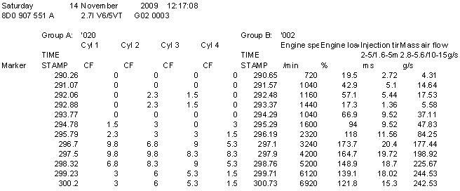

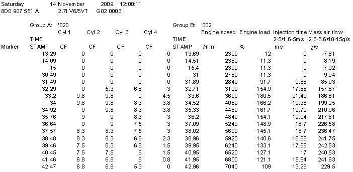

Should I pull timing(CF)? Stock air box for g/s#s seem low. For a apr stage 2 the FATS calculator says Im slower than stock(7.25sec). Ive done 6 runs today and they all seem close to these attached. Unisetting wont read but will write/ Lemmi reads and writes. I only have the freeware vag so before I dish out $(full version) I want to see results. Searched back years all over, but cant find indepth info or help. Its all superficial. Perhaps someone could chime in and educate me.
