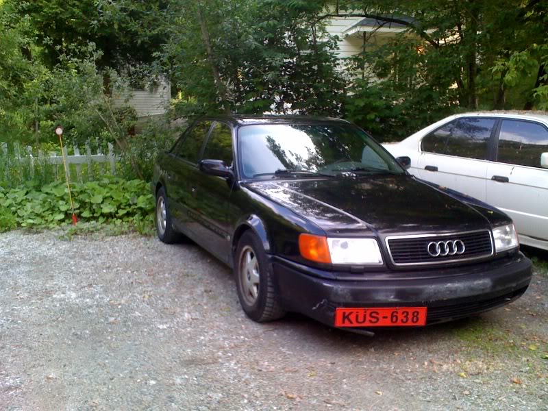

Hey there audi anthusiasts. I'm a new audi urs4 owner from Canada.
I love this car so far. But there is few trouble with the car since i only
paid 3500 $ cdn. It only haves 150 000 miles on it !
Brakes are dead must replace disc/pads
a seal from the diff is leaking
it needs new winter tires
The body is in "ok" shape but not perfect.
There is also a minor leak of power steering liquid from pump.
last thing is air in the brake lines.
This may looks like a big problem list but i'm willing to do what must be done to make her in good shape !
here are some pictures.

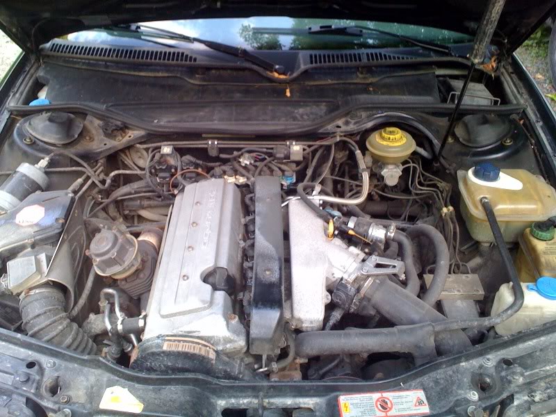

That's a huge wastegate BTW!
