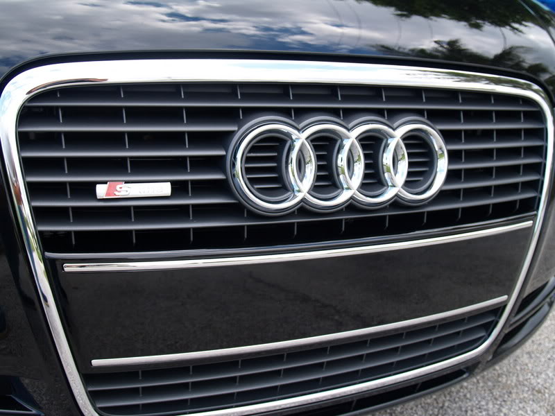

Nevertheless, it will work. Just remove your "Quattro" emblem by popping the clips out with a tiny flathead wrapped with some 3M tape so you do not scratch your emblem or grille.Remember which way the clips bite down to hold the emblem (If they come completely off the grille), place and snap clipback on the grille and insert your new S4 badge. You are going to need something keep the clips in place in order for them to connect to the S4 badge. Remember,one clip at a time. I believe I used my idex finger to hold the back of the clip from moving. Make sure they are butted up to the grille snug prior to inserting the badge. The clips can be a bit stubborn, but be patient.
I hope this helps, I probably just confused the **** out of you, but it will work.

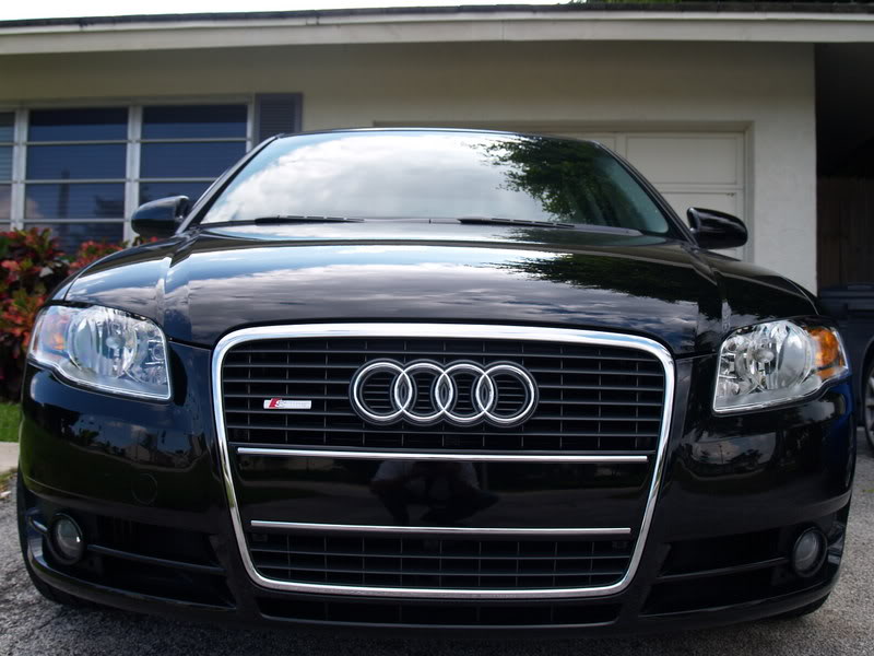

Are you refering to my grille panel that is painted? I sanded it down myself, epoxy primered it, sanded it some more, two coats PPG Brilliant Black, and two coats PPG clear.1 final cut, and abeautiful buff.
Good luck bro.

and umm yeah.. your instructinos confused the HELL outta me lol. Did you happen to take any pictures when you were doing yours or used some kind of online manual? Because I'm afriad of just using a flathead screwdriver and pry the tab off =(
