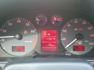

Got my cluster back this morning! Took about 2 seconds to put back in. It works great! It's like sitting in a new car again. haha! Anyway, here's what the receipt says...
"Replaced center LCD with a panel that exceeds OEM specifications. Recalibrated all gauges and tested. Includes lifetime warranty on the LCD and a 5-year warranty on all other repairs if applicable."
I got the next day air return shipping, so their bill was $208.00 plus I 2nd day aired it to them(So about $238 total). It took them 1 day to do the repair and shipped out the next day. The panel color matches perfectly, as I know some out there say there are LCD panels that the color does not match perfectly. Overall, one of the best values for the dollar yet!
www.modulemaster.com
