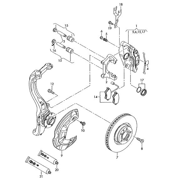

I would look at the bushings that allow the caliper to float side to side, #15, and make sure that the spring clip #4 is on each caliper. The clips apply downward pressure to the pads and should help stop that annoying squeal that some cars do, and I'd think keep the pads from making noise too.
That red paste is an antisqueal compound, like a silicone. I've used that, and an aerosol antibrake squeal product that was blue, those don't always work for brake squeal though. So that red stuff would only work temporarily as you know, and if something else is wrong it is no substitute for worn bushings or parts missing.
I would think the shop checked out both my suggestions first.

That's great info, I have an appt today and I am taking that printout with me.
