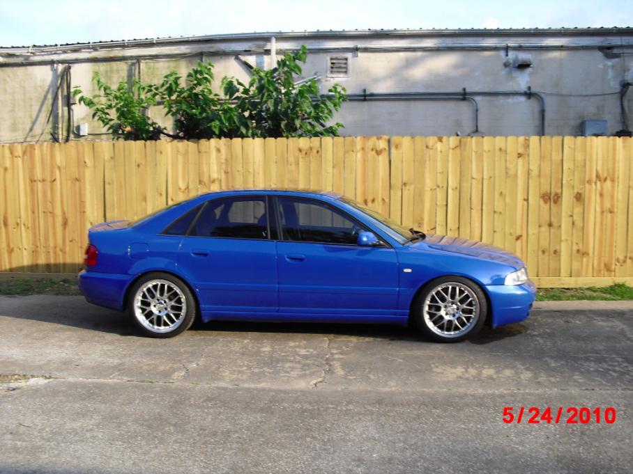

I have a 2001 nogaro blue s4 and i love it the current mods i have are a
GIAC chip and borla exhaust (no cats)
I have a plan for my s4 and its to go stage 2 + water / methanol injection
So right now I believe im at 320 hp 340 tq, I have a GIAC chip but I want to get a apr stage 2 tune. I have my stock ecu and then the GIAC ecu.
