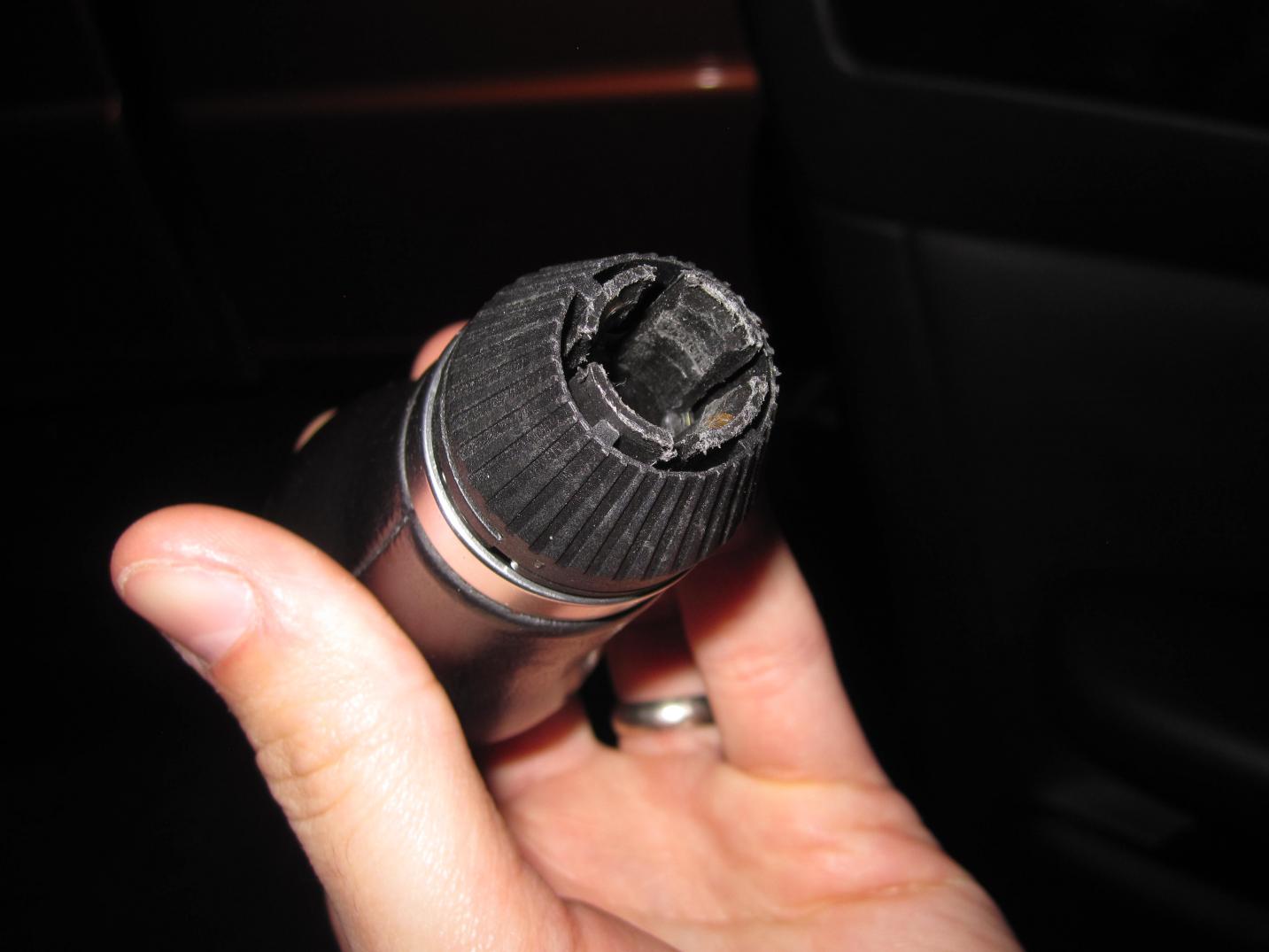

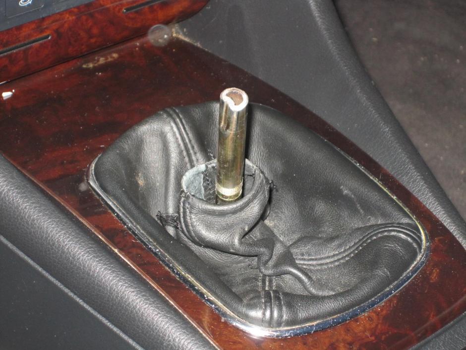

On a semi-related note, the shifter handle keeps popping off. I was surprised that there was no thread on the actual shifter. It seems to be "held on" by a friction fit twisty ring on the bottom of the handle. I'm guessing this isn't the way the stock handle is held on?

For anyone else who might be having these issues in the future, the shifter is perty well boogered. I'll need to replace at least the shifter, but it looks like it's working for now. The goon who had the car before me I think just modified the stock shifter to be a short throw, and in the process swapped the bolts for the transmission brace and the shift rod. The bolts were tight, but since they weren't in the right place, the transmission brace had slop like none other. The "second stop" feeling was actually the entire shifter base sliding back.
I was also having problems getting it into reverse, which is what tipped me off that it might just need to be re-aligned after doing some reading. Following this process, I got it figured out and done.
