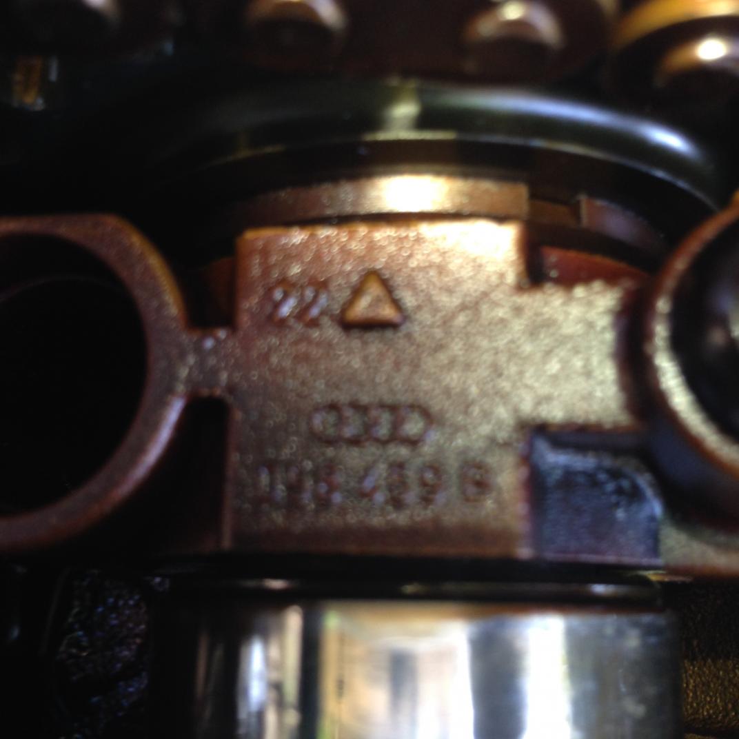

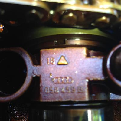

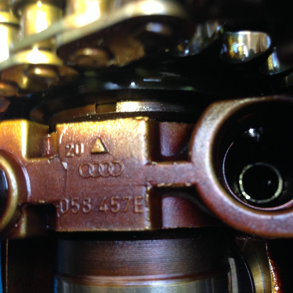

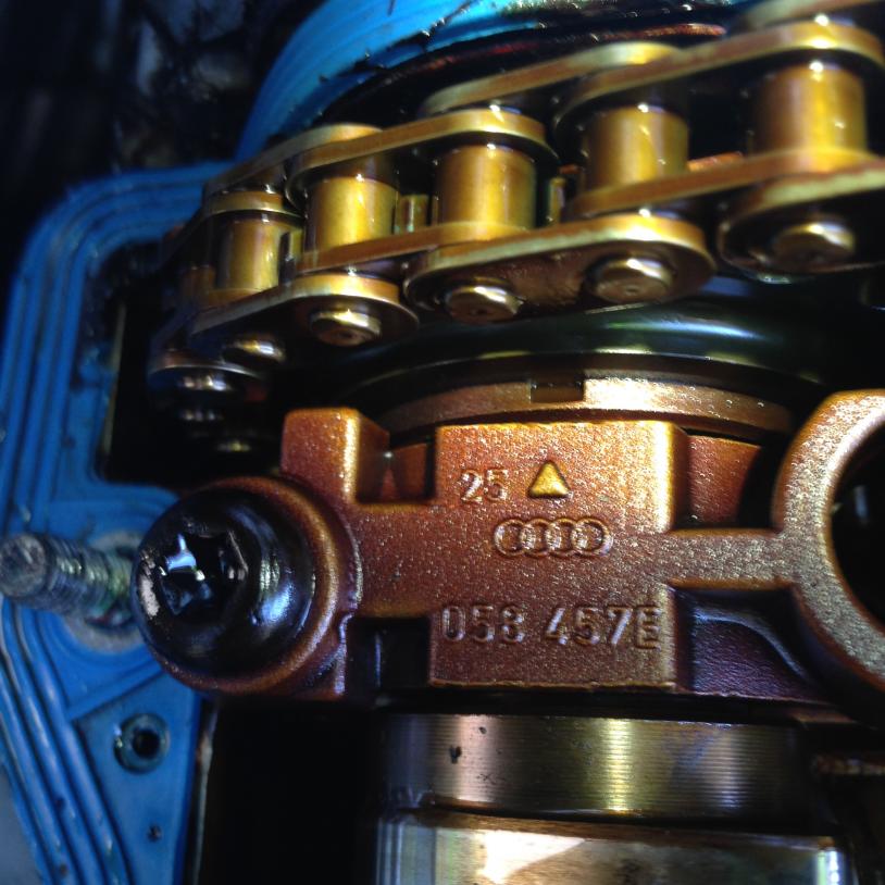

I bolted the cam "guides" back on and put the timing belt back on and....the motor turned over several revs with no resistance. I now have the valve covers off, a step i had skipped before, and I checked the timing marks on the timing chain inside that link the two cams and here is what I see. The second pic from left to right shows the intake cam for cylinders 1,2, and 3 is off like one tooth. There is a, what appears to be hydraulic, lifter that moves up and down that is placed between the two cams that is making a clicking noise as it moves. Both sides appear to be very slightly out of sink at certain points in a revolution. It does not all seem to move smooth.

My questions are these, and since Paul is the only one participating in this I gues Ill have to send him a check when this is over.
1. Could the rough running I described early on in this be attributed to the Pic above and could that also be the cause of #1 recording poor compression?
2. Can the cam chain and tensioners be changed without removing the heads and IF they can is it still recommended that you not do it that way?
I will ask a friend who works for Audi, I've had to replace a chain and tensioner but only done it when the head is in pieces.
You could try the compression test again and see what you have ........without the cam lock in place ........

My friendly Audi expert took a look at your pics and there is definitely something wrong with the timing settings. If the timing is off then you will have a rough running engine. He recommends taking a look at the tensioner as well as the chain. Its a few years since I had the pleasure of tearing into a 2.8 but i do remember that I replaced both chains and tensioners when I rebuilt the heads after an idler pulley broke up.
Did you run the compression test again ?
