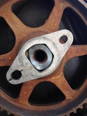

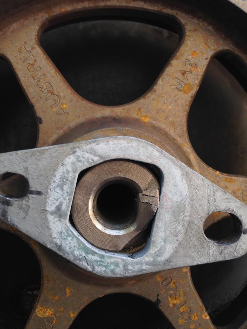

I will but it gets worse. I had no clue the starter was soo powerful. Look at these pictures of the cams.
