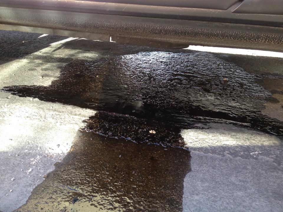

To tow the car was a lot of money. I didn't want to spend a lot of money just to tow. So, I took a risk of putting enough gas to get me to the shop. Drove the car their, parked the car. Took a picture of the leak. Enormous leak. Others on the road was rolling their windows telling me "sweetie, your leaking really bad gas" I was like, "I know, thank you, that is why I'm heading to the shop right now." I got to the shop, parked the car. This is how much leak was coming out:

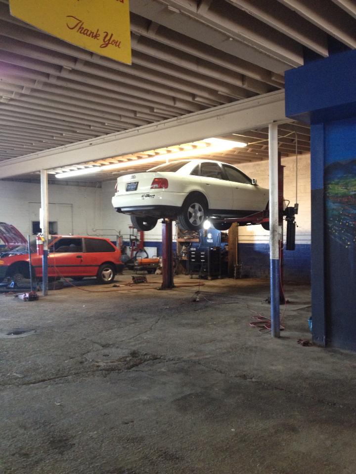

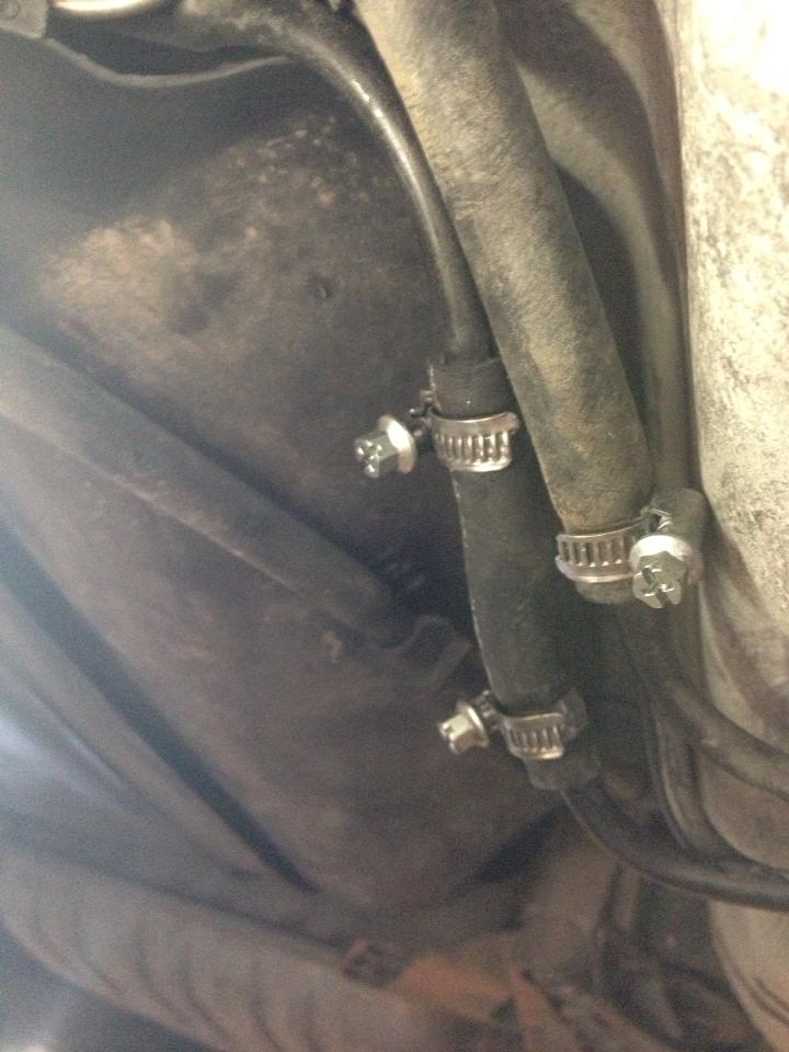

then finally, looked under there. My mechanic told me, whoever fixed this before, put a "water hose" instead of the actual fuel supply line. Whoever that person, connected the cut fuel supply line with a "water hose". It cracked. I mean its hot here in vegas, I can't imagine how hot it must be under the car. This what it looks like:
Result:
Temporarily, I had my mechanic get a thicker and harder hose, they did the same, just for temporary. I'm going to order the fuel supply line, then have them fix it. All in all this is what was done to my car, cost me $30. Saves me a lot of money because I'm not draining gas and I can use my car enough to go point A to point B.
