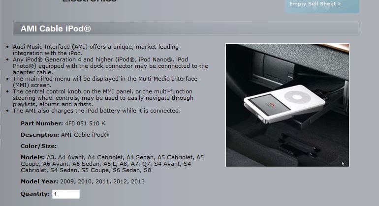

Your vin shows your car came with a cd changer in the glove box. Was that removed? Do you have an ipod dock that looks like this picture below? If not do you already have a cable coming out of the glove box? I assume you don't otherwise your question would have been why doesn't my ipod fit this cable sticking out of the glove box. Plus you've already mentioned you have the blue cable so I assume you do have this dock and the cable you have does fit the dock and your ipod. What generation ipod do you have? I know you don't have MMI, so somebody could have installed a dock as shown in the picture but maybe there is a problem with the harness from the dock to the back of the radio. Firmware updates to your car are done through the cd changer that should be in the glove box. We have customers that bring in their glove box mounted cd changer when a firmware update is required. The tech then swaps the ipod dock out for the cd changer and does the update, then swaps them back. Let me know, interested in what you have.

We have the AMI that is in the picture above. Not sure about a cd changer, there is nothing else in the glove box. Would it have been in the same slot as the current AMI? Our I pod is I think a 2008 the Nano is a 2010 the I phone is a 3GS and a second generation I pad non of which worked.
If someone had a cd changer and wanted to upgrade to an I pod player would it be that cut and dry. Pull out the cd changer and replace with the Ami?
What do you recommend for a next step to get this thing to work? Do I need a software update and if so do I need the cd changer to do it?
