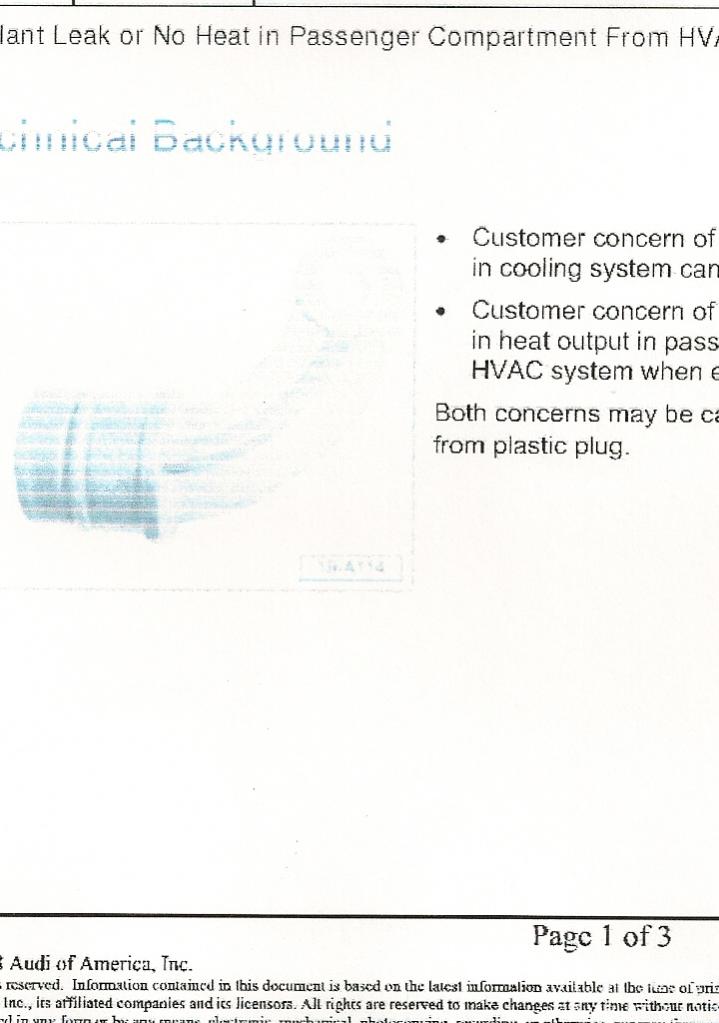

#15
Loss of heat in passenger compartment
P3081 or VAG 19537 Engine Temperature too low
Check Engine coolant temperature (ECT) Sensor. Check thermostat.
There was a service bulletin on this as well!
The problem plug allows air into the cooling system which can also cause the cooling system to loss effectiveness after warm up.
At least this is one more thing to check. Hope it helps
