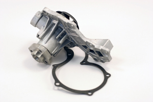

You have a 06a motor which has a internal water pump which IIRC runs off of the timing belt.
Here is a water pump for a 058 motor which is used up till 2000. It is turned by the same belt that turns the power steering pump.
Thanks! 1 question down, 2 to go.
(well - and 2 followup questions on the water pump) So as far as the waterpump - 'internal' is referring to the belt that drives it more than to it's physical location? How long do the 'internal' waterpumps last? The previous owner had the timing belt replaced, but he does not know about the waterpump. He didn't specify it, and the shop didnt say anything about it. (I've met the previous owner, I copied his name off the title when I bought the car and he was kind enough to return my call).

Your waterpump should be replaced every time the timing belt is done ~65k miles. No your waterpump is not something that is really "internal" compared to the other ones, its just different and on a different belt.
