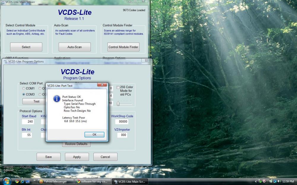

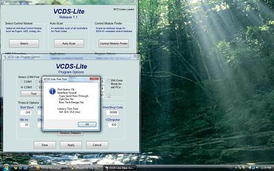

so this is what i get but still i don`t understand why the only thing is dectecting is the radio module,and what i noticed when it scans is that only at the radio module switches to baud 02 on the rest doesn`t is only 00 or 01 on all attempts why is that ?

Latency Test: Poor
I assume you are using some type of 3rd-party USB interface?
If it uses an FTDI chipset, install the latest drivers from ftdichip.com, and then crank down the latency timer to 2, as shown in this screenshot.
If your interface uses some other chipset, talk to your interface supplier.
-Uwe-
