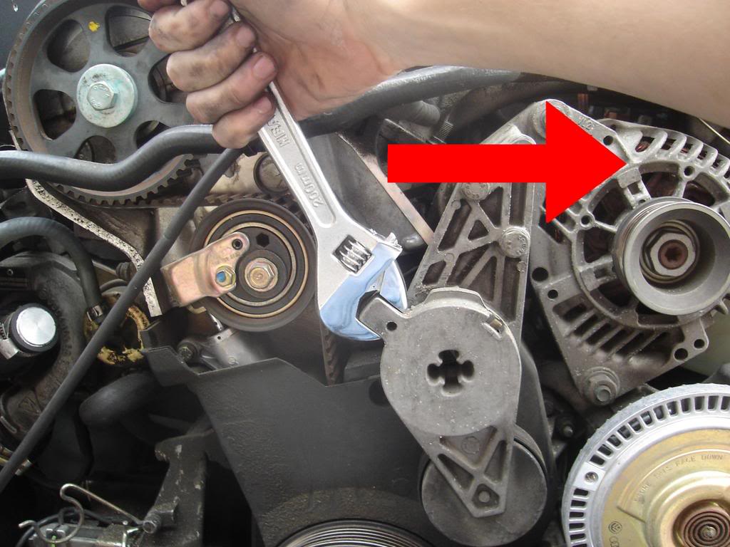

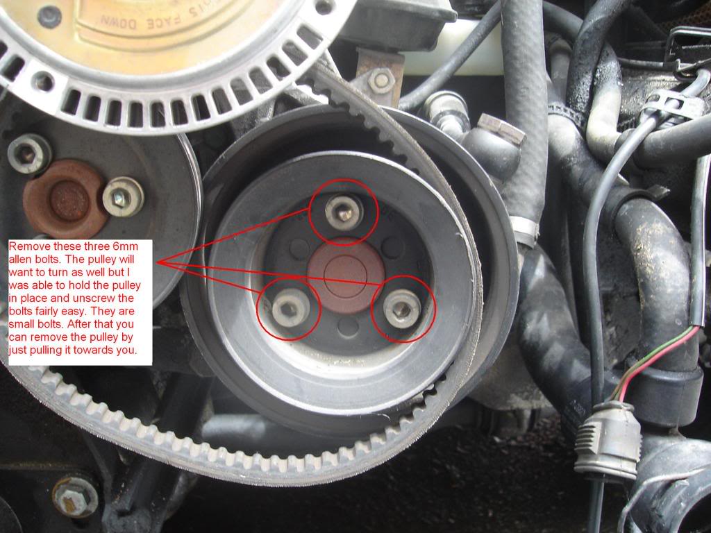

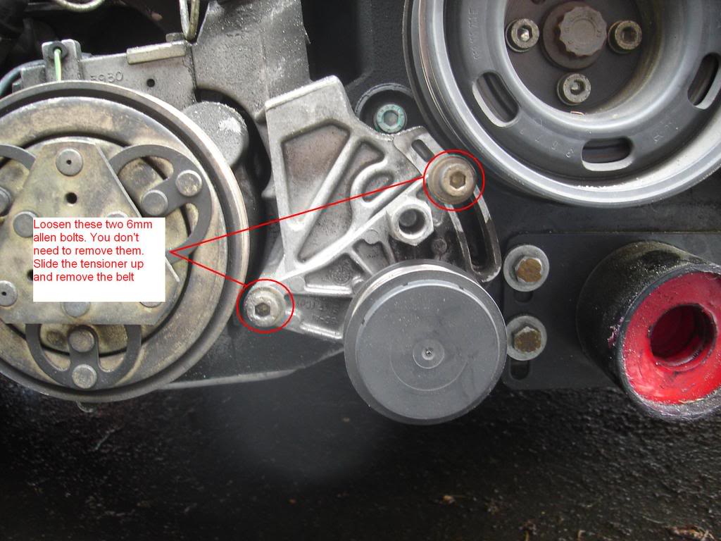

i wrote a DIY article for the belts but i guess it got deleted when they switched the forum. you gotta remove the front clip. for that you can use the timing belt DIY on www.audidiy.com
once you do that here are the pics i had saved from that DIY, they should be enough
main belt comes on and off w/ a tensioner

a/c belt

you need to remove this pulley to do the waterpump belt
