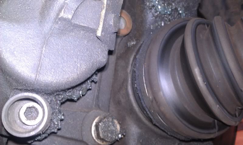

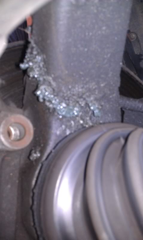

so I pulled the rim off the car and I saw that the top bolt was just missing

and apparently not a damn person sells that part in town

Just go to the Hardware store with the other one and match up the thread pitch, diameter and length. Make sure it's hardened. Look for 10.9 printed in the head.

Well thats where the auto store sent me, and when I got to home depot we looked through every bolt they had, and said I should check the auto store..ha

Go to a "real" hardware store. Home Depot, Lowes, etc don't have much for metric bolts. Fastenal, Grainger, or even the local Ace should have it.
