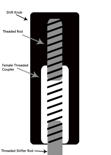

I basically drilled out the bottom of the **** to be a little smaller diameter than the shifter threads, then cranked it down. That's why the copper collar was necessary. As I was cranking down, I could feel the wood separating to accommodate the shifter.
If you wanted to do something a little more rigid, Home Depot sells female threaded couplers that you could press into the bottom of... well... pretty much anything. Just make sure that the metal is taking the brunt of the shifting force, otherwise whatever's wrapped around it is liable to crack over time.
Here's how I would do it, assuming I could find everything that's the same thread pitch.
Attached Thumbnails New 98 A4 Quattro: Couple things need fixing-untitled-1.jpg

do you know the specs of the shifter threads? i have some neat **** laying around id like to make a shifter out of

Looks like 12mmX1.5.
Might need to go to Ace Hardware or some specialty hardware store to get everything you need. Home Depot tends to have mostly English standard sizes. Lowes might have it.
