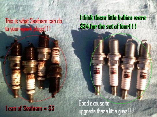

btw my 1.8t was filthy with sludge.
I have already pulled and cleaned the MAF and the TPS. I also acted like a bit of a retarded monkey when I was seafoaming... possibly used too much and pretty sure I overboosted during the "fun" smokey part (if that is even possible).
