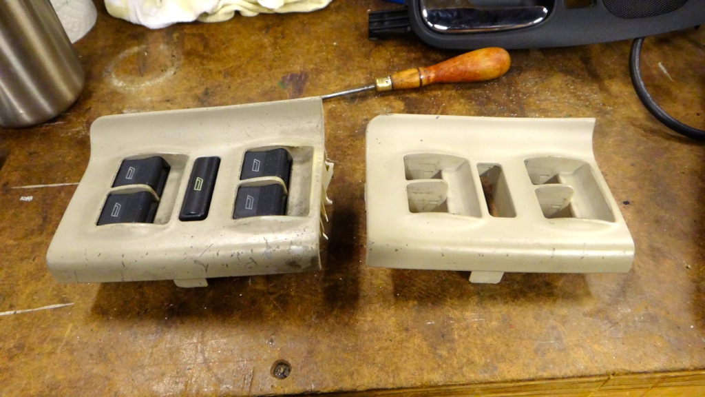

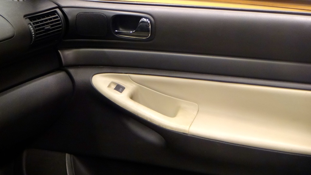

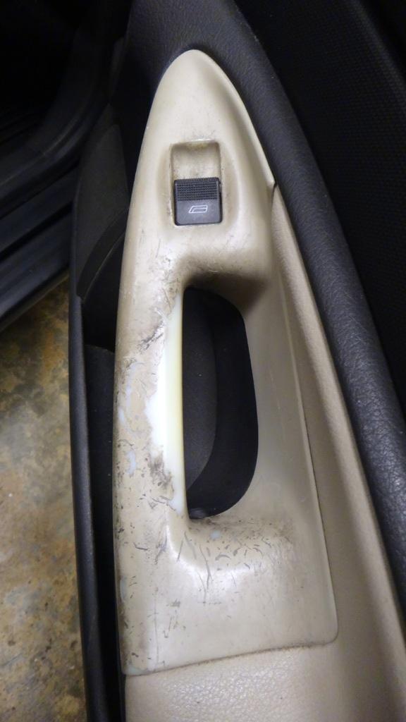

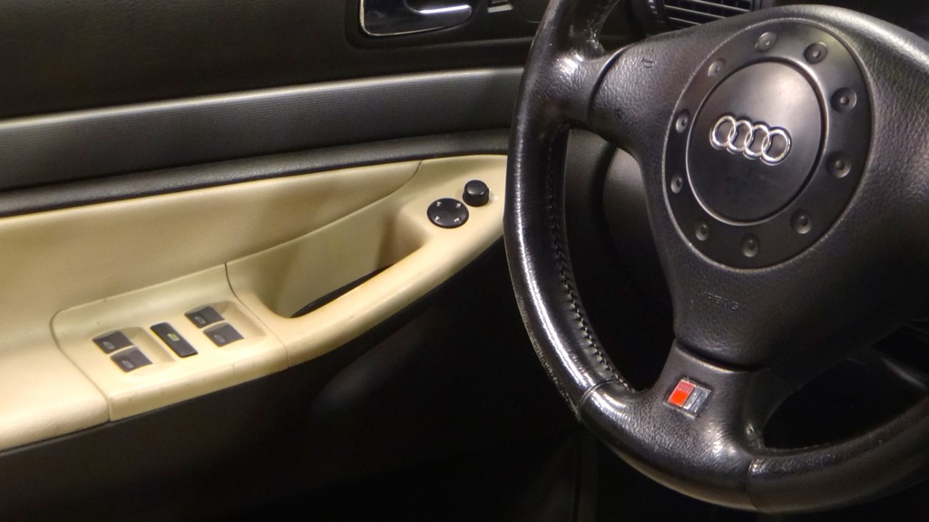

On a different note I got the new door pulls and latch installed. What an improvement!
Before:
After:
Before:
After:

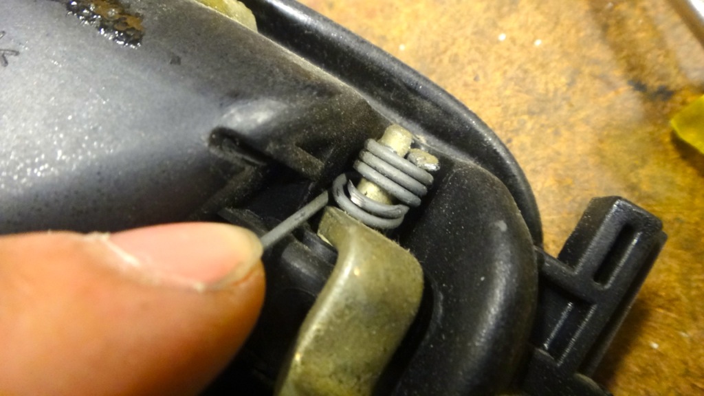

Oh and I found out why my door handle was floppy.
