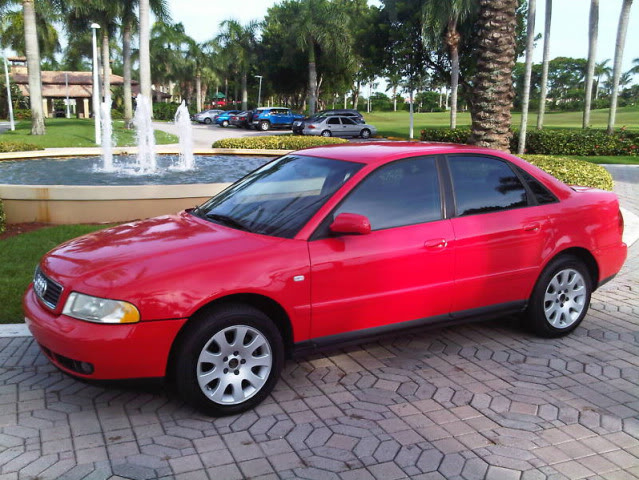

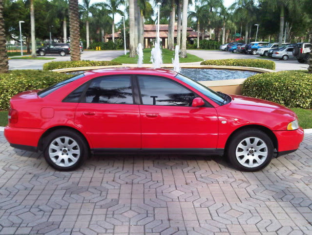

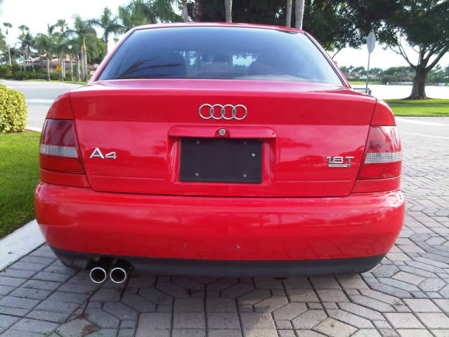

Hey guys, I just bought a '99(.5) A4 Quattro 1.8T.
I've come across this site, and after being in several forum communities for my previous cars, I figured my best source for information would be here.
Anyways, I'm going over in a few days to look at it and make a final payment. But, while I'm over there, I would like to know if there are certain things I should look for that may be wrong with it (known flaws, things that often fail in the A4).
I am aware that it will need to be repainted on the roof, rear bumper and trunk lid, also that the rear windows are unplugged due to them acting up? and that it does not come with a jack and tool set.
Here's the listing: 1999 Audi A4 Quattro
(http://cgi.ebay.com/ebaymotors/ws/eB...=STRK:MEWNX:IT)
If I could get any opinions on what to check for or links to other threads, it would be greatly appreciated!
Here are a few pictures from the listing:

Miles, price? make sure you test drive it for sure if you havent already pay close attention for any weird sounds. also when the key is in the ignition make sure CEL at least blinks cause is could be unplugged from the back (hapened when i bought my car didnt realize)
ask for all records you can get for all previouse work and just be aware of what your getting. interior looks pretty messy from the pics

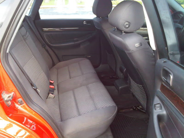

In the picture that's looking into the back seat, does the trim on the door look like the wood trim? or could it be a reflection?

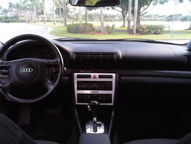

On the dash, along the carbon-fiber-looking trim, is there supposed to be a "Quattro" emblem on the passenger side? or is this just an extra option?
The silver trim that onepoint8tee pointed out doesn't seem to be original, but is the carbon-fiber-looking trim?

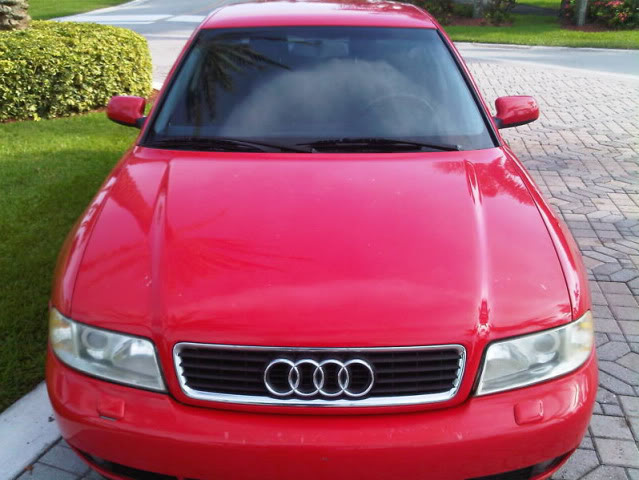

The wood trim in the back is stock, the carbon fiber in the front is a replacement. There should be a quattro emblem on the passenger side, as well as on the front grill. Since it's not in either location, I hate to tell you that you most likely have a FWD car.
