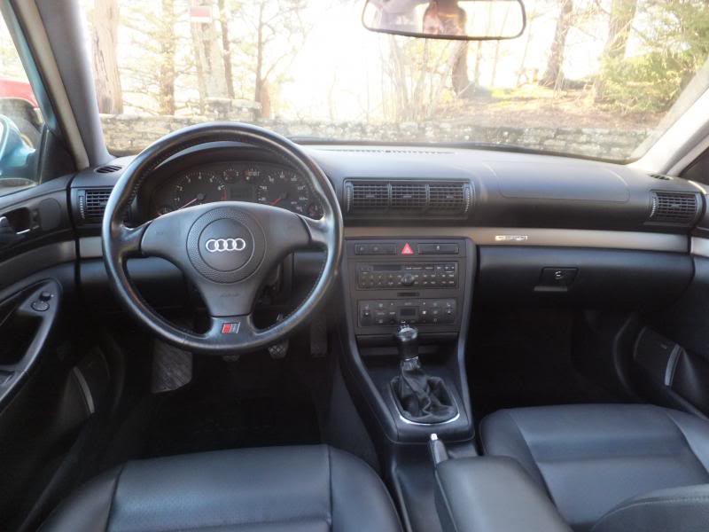

The cruise control doesn't work, but the stalk control has a piece broken off, so hopefully that is the only problem there. The dealer dropped the price from what we had agreed on previously when that was discovered.
The speedometer turns out to be temperamental. It ticks up and down by increments instead of a smooth motion. And at times it has settled at 10 - 20 mph lower than actual speed. Not sure what the issue is there.
Last issue is the coolant temp gauge. It's showing almost completely over to the cold end all the time -- but the car is able to heat the interior just fine, so I'm not sure what's up with that. Any ideas?

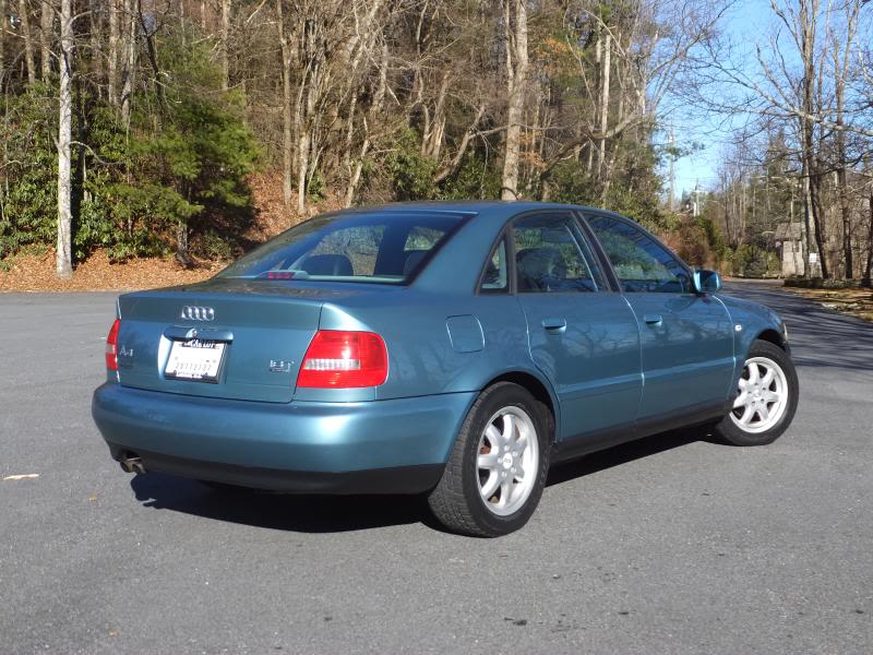

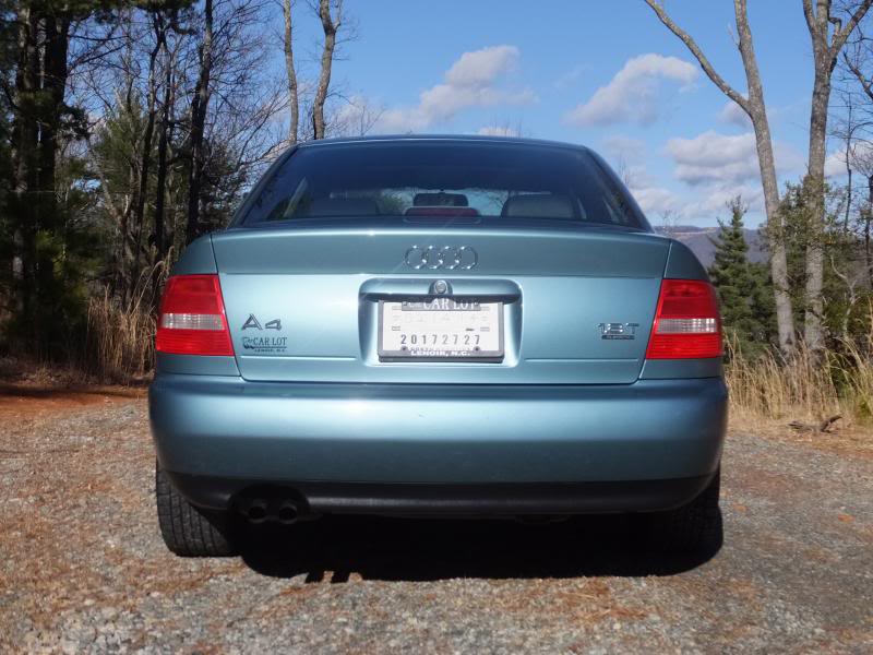

The dealer ^decal will be coming off ASAP. I mean, they were really good folks (I don't often enjoy spending time with used car salesmen), but that decal doesn't belong there.
And on the Blue Ridge Parkway....
By the way, I had been told that these are "the regular old wheels, standard equipment for that year" - turns out, they are the Sport wheels for years 1998-1999.5. Thanks to **BaseDrifter** for the link with that info ( http://ctny.audiworld.com/mark/a4/diff/ ). I then found that confirmed elsewhere, and the car's original window sticker confirms it has the Sport Package.
