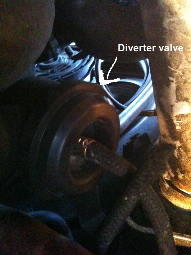

Thanks for the info onepoint, how would i check if i had a broken waste gate arm? (sounds intense)
Well i was out searching my car and i checked out my diverter valve and i found this....
The vacuum hose that exits the diverter valve is only about 8 inches and its totally broken. i looped it around so that you could see where it was in relation to the DV. Would this be my problem? Im going to get a new vac line tomorrow to replace it

Isnt that the hose that opens diaphram/valve inside? If im correct your DV is not letting any air out at all... Get a 007 or a splitter from forge.
It may not be the FULL problem, but it's definitely contributing. Dont just buy enough to replace that one line, buy a few feet of the tubing and replace every vac line you can get your hands on. The factory tubing is notorious for going very brittle very quick and if that one is completely shattered, chances are more than likely the rest are all on their way out if they too havent shredded yet.
