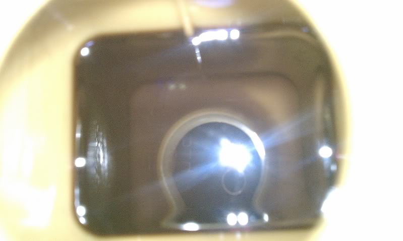

Wait let me back up, I've had this bad smell of burnt a-hole every once in awhile, my guess was the clutch since it has been slipping. So I open the hood and on the driver side next to the fender is the reservoir to what I believed to be the clutch fluid, but I always thought it shared with the brakes, which is up by the firewall next to the battery... Well when I opened it the fluid is black and matches the burnt a-hole smell. But when I check the brake reservoir is was fine. So I contacted the devil and checked his Haynes manual to see what it said about draining the clutch fluid and it literally just says "drain fluid" doesn't say where. So how do I drain that fluid and if its not the clutch WTF is it?

Thats your power steering fluid reservoir in the pic with the green top. Based on the service manual i downloaded from the maintenance sticky, the clutch master cylinder shares a reservoir with the brake system. i even haz pic:
If your power steering fluid is black and smells like doodoo i think you've got somethin else goin on...does your power steering pump make a lot of racket?

CCA4 so I'm only half retarded! And nope the steering is fine no noise, nothing. So should I drain and replace?!
