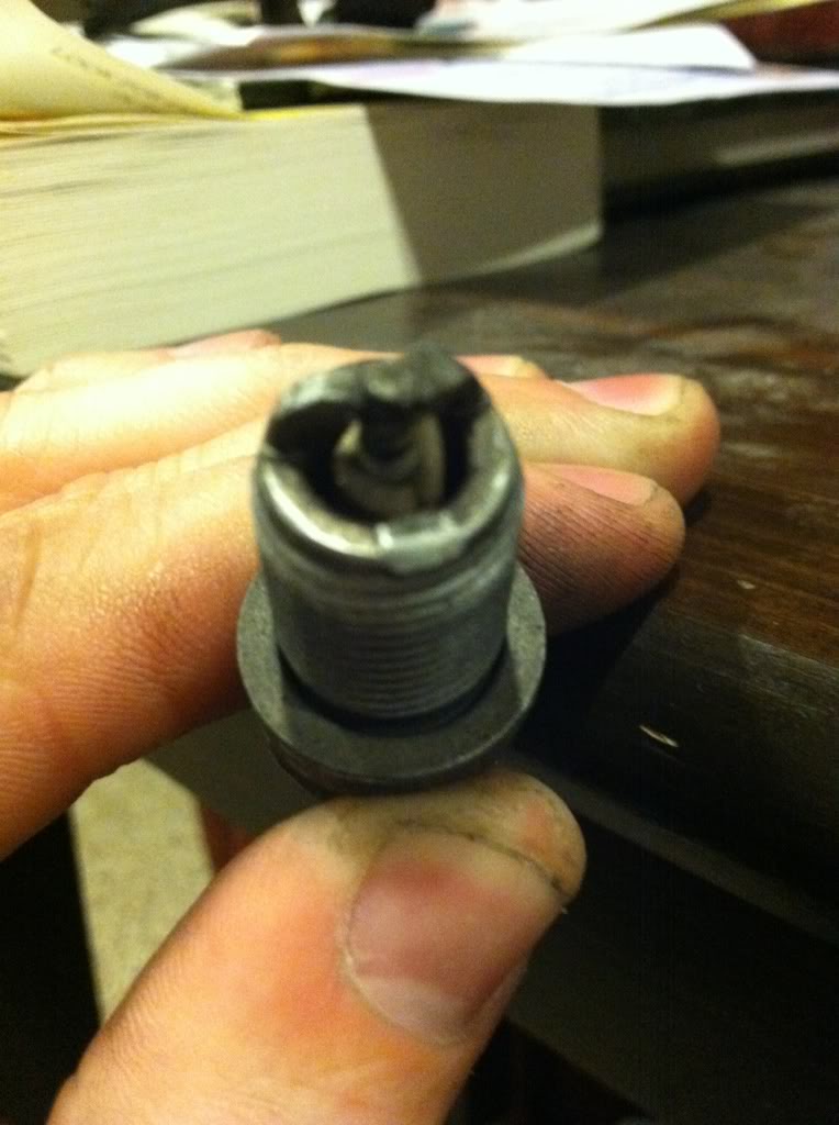

Spark plug 1 ( the one that shot out) :
Image - TinyPic - Free Image Hosting, Photo Sharing & Video Hosting

im going out on a limb here and going to say you have not been tightening you plugs enough. the threads in #1 look good, but i cant for sure tell. this means it backed out. if all the other plugs were loose, it tells me you just arent torqueing them down enough.
there are two types of washers that come on plugs. one is like a regular washer. after getting tight, they need an extra quarter turn to torque well. the others are like a lock washer (AFAIK all car plugs fit under category 2) and they need a 3/4 of a turn to torque well. if you go to the store and check out the box of a simple ngk spark plug, like a br9es, it shows right on the box it needs between a 1/2 and 2/3 of a turn extra after getting tight.
however, the #1 plug looks like it had contact. i'd like a close up of that plug. and please embed the photos next time.
i really dont think this is much to be alarmed about, but i could be wrong. if that plug had contact, its pretty bad

Yes thats what Im worried about, the plug did have contact, but couldnt the plug have just gotten damage from shooting out? I Im hoping i just didnt torque them enough haha. I will upload more pictures now. The fact that the threads are only kind of fucked up at the top tell me it was already loose and then shot out. I got a different spark plug to thread in as well. When I took it out it had metal shavings on it. But it seemed to thread in and tighten nicely. My phone camera kind of sucks. One of the three posts of the spark plug that u gap from electrode broke off and the other two are now touching the electrode so something happened.
