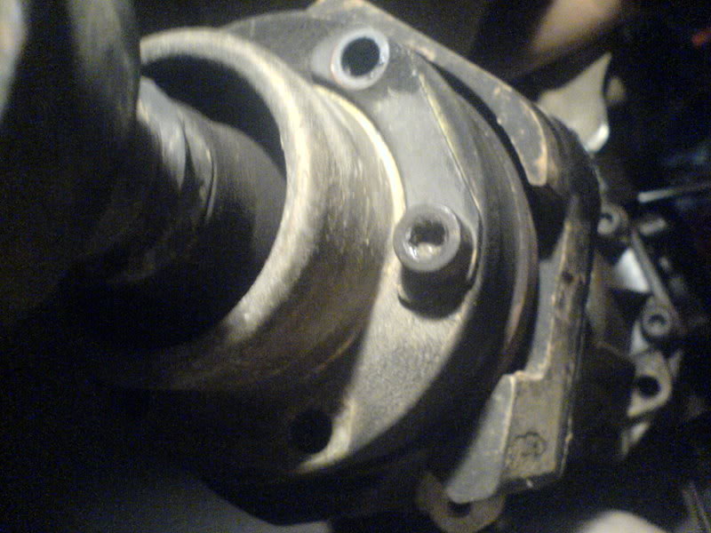

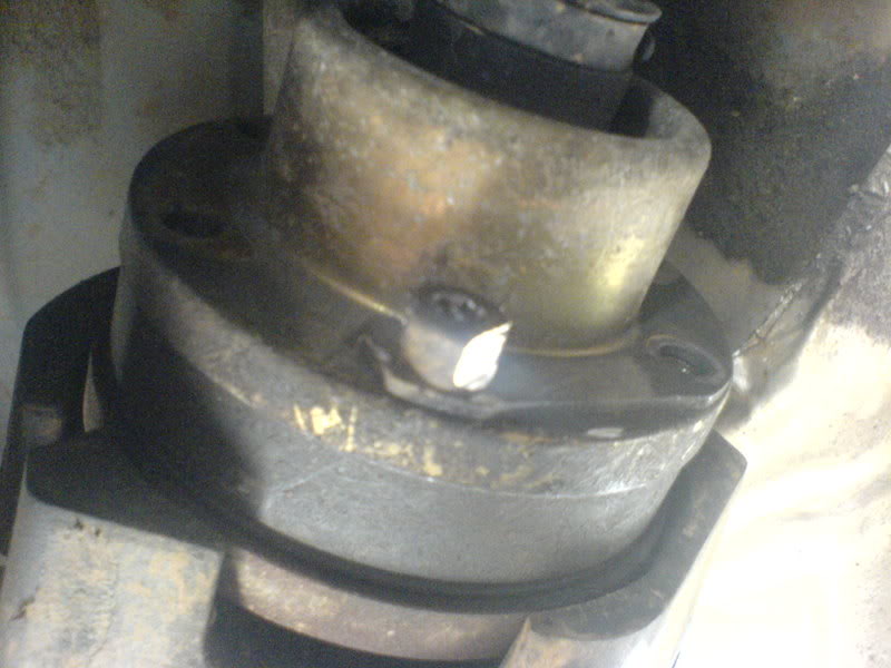

I stripped one of the driveshaft bolts . One of the guys has a dremel at his house with a cutting wheel, so after he wakes up (that lazy ***), we're going to run and grab it. I'm hoping we can just cut a slot in the screw and use a screwdriver to turn it out. there's really not enough leverage to hammer a t45 torx bit into it.
So I tried to throw some vice grips on that bolt, they just slid off the bolt when we tried to turn it. Then we used a grinder to make one of the sides flat (more grip!?), but it just rounded the edge of that side.
We can't heat the bolt, I only have propane and I think it would damage the stuff around the bolt. The grinder is too big to cut a slot in the head of the screw for a screwdriver, so right now we're pretty stuck.
I was thinking about using easy-outs, but I've heard horror stories of using those.
Then we cut a slot in that head and pulled off that screw with a BFF (Big ******* Flathead)

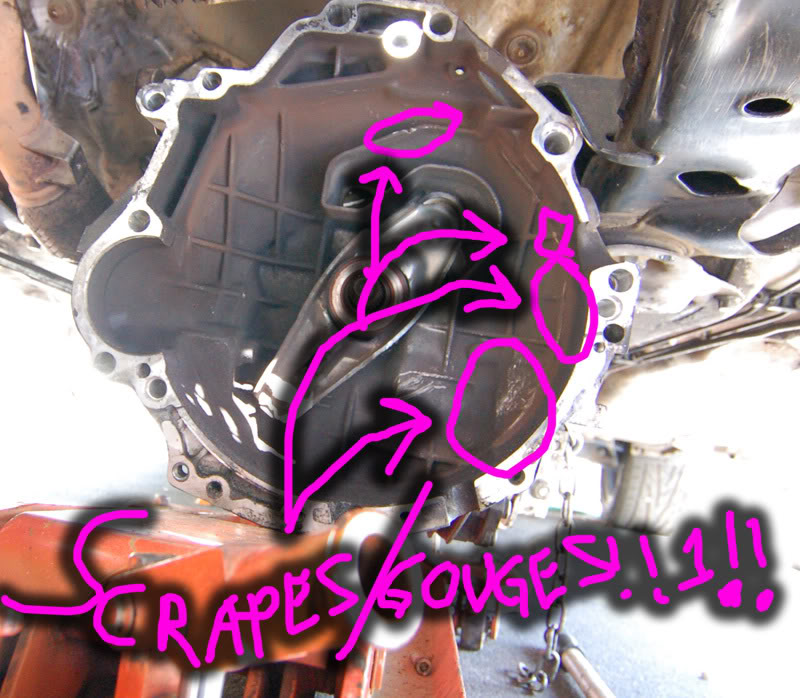

After we finally got the transmission out, we realized that we couldn't get the car high enough to pull the transmission out like we thought. We just moved it out of the way under the car.
Something interesting:

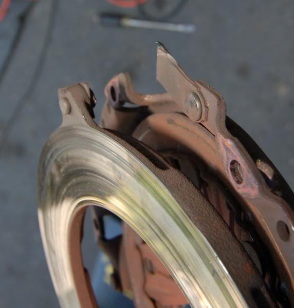

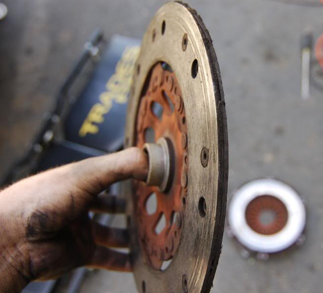

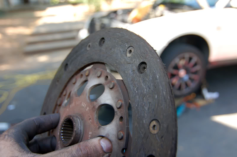

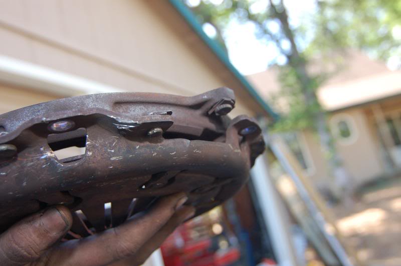

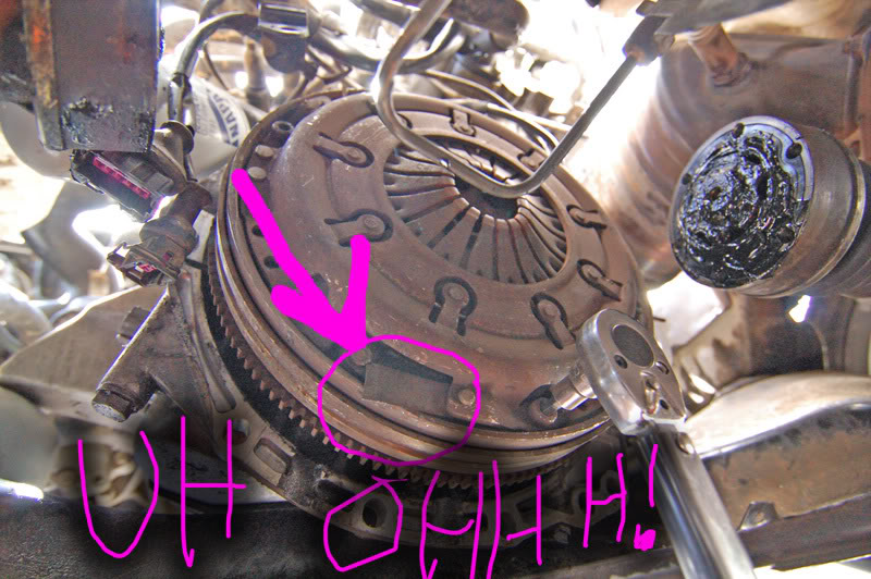

Damage pics after we got it all out:
[these were broken before we pulled it out-- no, I don't know where that missing piece went that's in the second picture]
Think I had a lot of life left in this clutch?

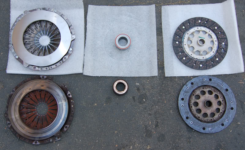

Annnd here's the old vs. new stuff:
