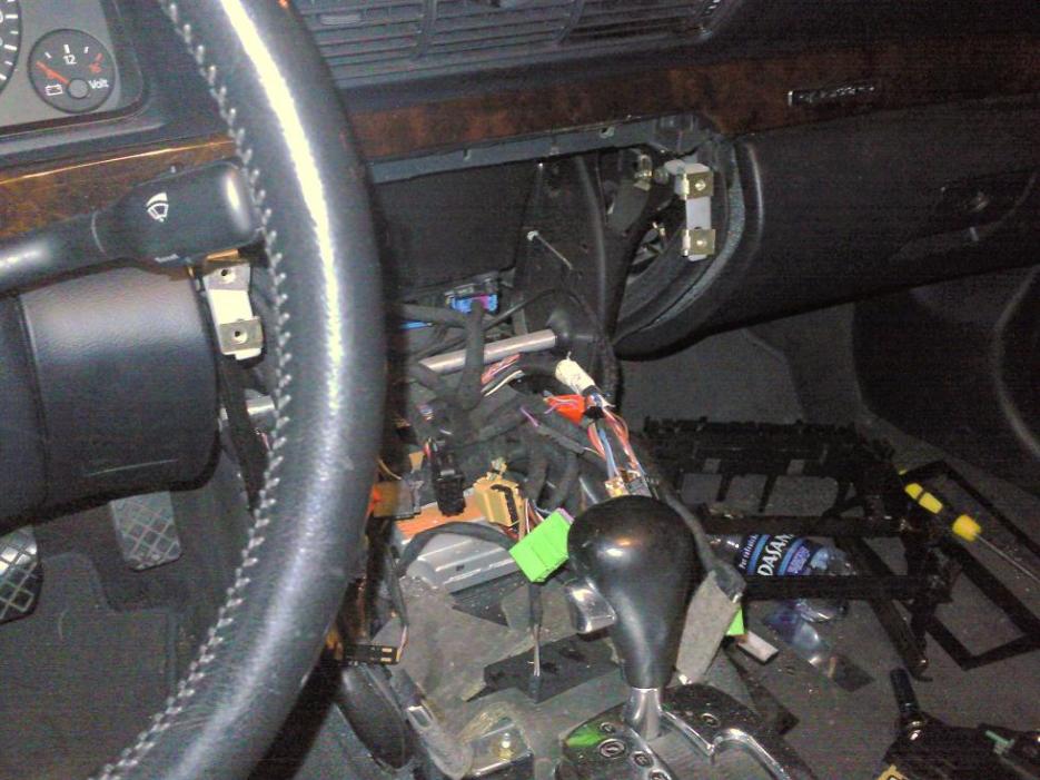

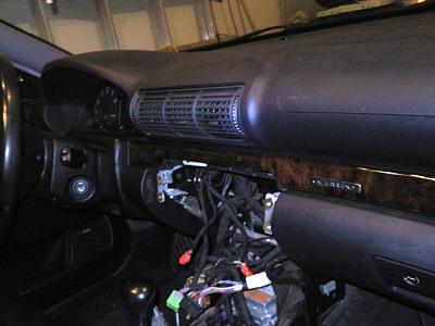

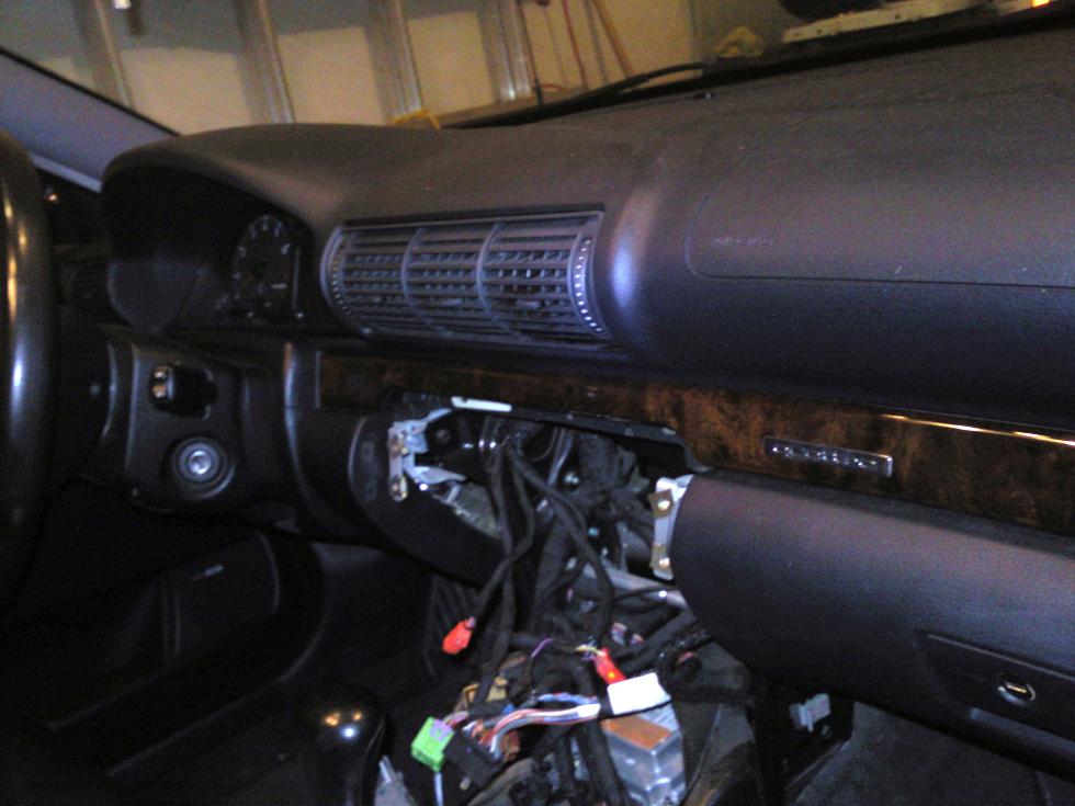

Sorry for the poor pics. It got dark pretty quickly, and working in 33'C heat was not fun. We managed to get the centre console out without removing the rear centre console...But i think its best to remove it.
Just curious if anyone else managed to removed the dash trim just by prying it. My friend manage to pry one end, but it seems like the clip from behind fell so now does not clip back in. I plan to put carbon fibre from ECS tuning on them, and paint the shifter surround and the trim around the ash tray to piano black. Should i take the pieces somewhere to get it painted piano black or is it pretty easy to do?

Painting the trim should be pretty easy to do yourself. It's all in the prep work. I'm in the middle of the same swap, but mine is more in depth because I'm swapping all Pre-Facelift parts with Facelift parts. The HVAC controls do seem to want to cooperate.

I remember seeing a DIY about changing the trim. To properly remove all the trim pieces its much more involved, sorry I don't remember the exact steps to it. But try searching for a DIY.

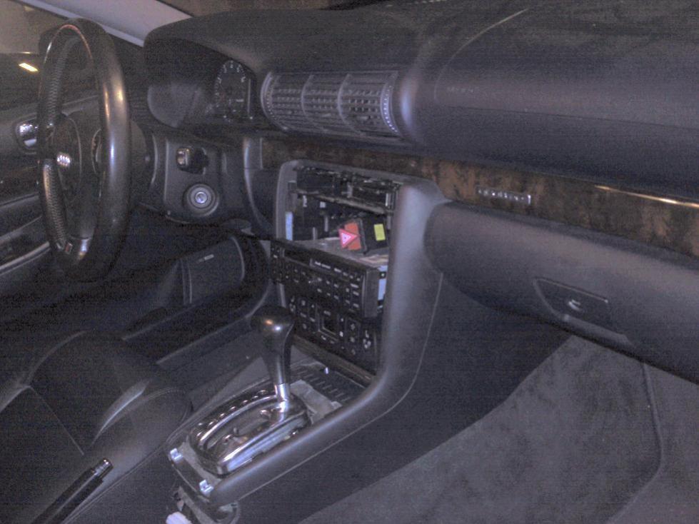

found it... for anyone doing this swap and need to know how to remove the interior, follow these instructions.
http://www.audizine.com/forum/showth...hortcut-Method
i've put the front centre console back and waiting for a radio and a donor for the shifter surround, maybe even the chrome trim around it. doing this made me realize how easy this was.

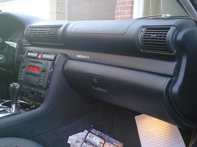

thanks guys for reassuring me on the radio connections. got a few packages delivered today, one being the radio. still waiting for my shifter trim.
i did a trial on the 3M dinoc wrap. im contemplating if i should apply some clear gloss on it...
