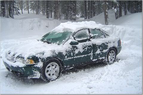

edited to add some pics for fun, i do love the car. digging it out of 12ft of snow many years ago.
