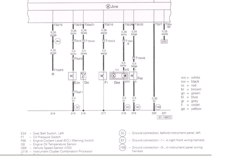

I cant help you with the screwy tachometer signal (it sounds like a short of some kind or bad ground, and sounds pretty hard to find), but the reason the oil pressure light comes on is this: the cluster expects the oil pressure switch to show low or no pressure when the engine is off (0 rpms, open switch), so when it sees the oil pressure is above that when the engine isnt running (switch closed), it thinks there is a problem with the oil pressure switch and turns on the oil pressure light. On a side note, the cluster will not illuminate the low oil pressure light while the engine is running unless the switch shows low pressure (open) AND the engine is above 2k rpms, this is because the idle oil pressure is not enough to make the switch close, generally.

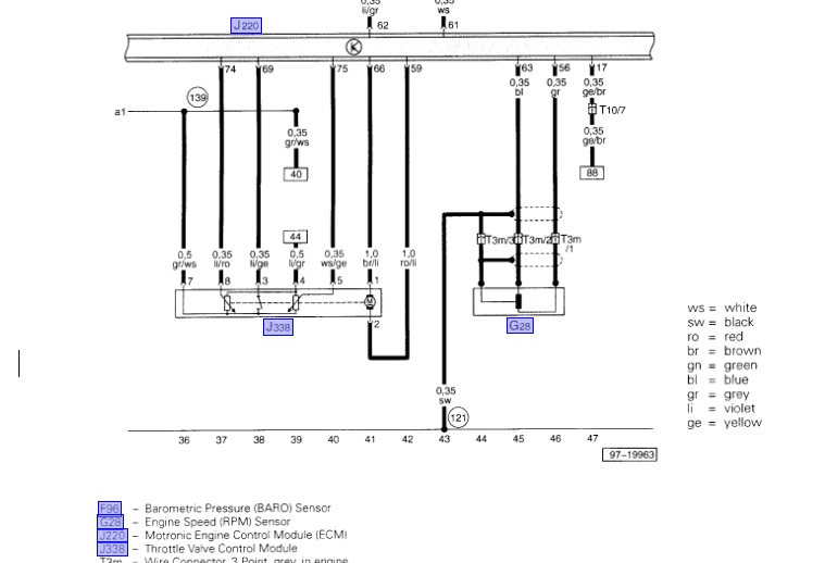

The tach signal should come from the crank position sensor as far as I know. It is sent to the ECU and then out to the cluster. You would have two sets of wires to ohm out and inspect - sensor to ECU and ECU to gauge cluster harness.
