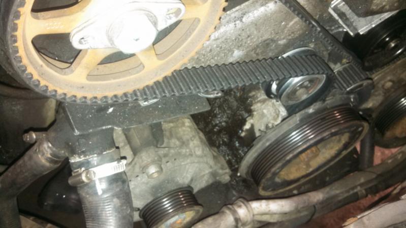

Dropped her off at the shop sounds like passenger side front not ps pulley though

Think its your alternator. Thought I saw the belt jumping around on the pully just before you ran to shut the car off, but the camera was jumping around so I can't be sure.

Right it was 4am with no gloves on hands were shaky cold lol ya I'm hopin that's it cause in finically tapped out if it's a major issue

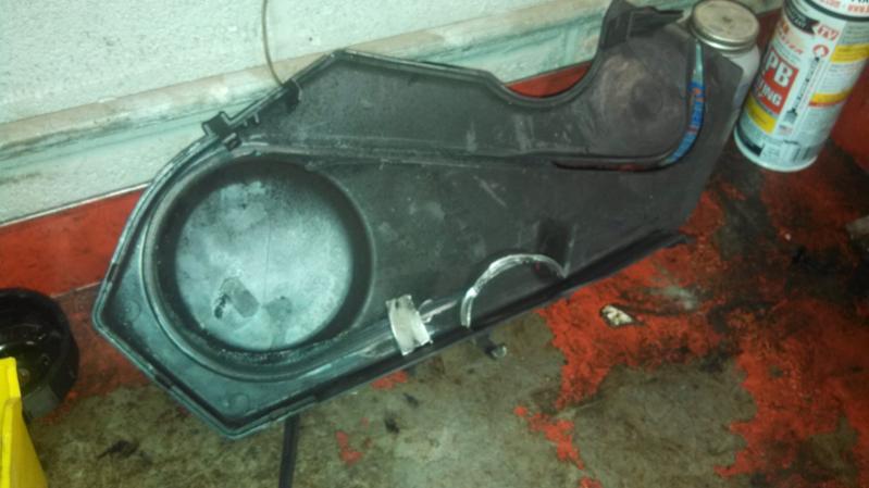

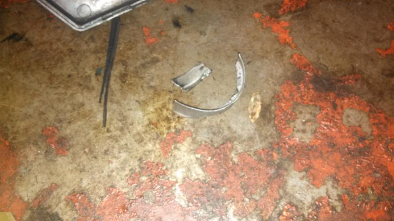

Here's the failure

Wow! What a piece of ****. And you drove it how many miles on that part? 100? You were way too close to losing that timing belt...and the whole motor.

Total maybe 250 miles but between 100-250 mechanic said some of the parts say made in slovackia

And ya he said it almost slipped off but was barely on the pulley more then luck lol
