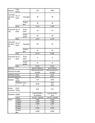

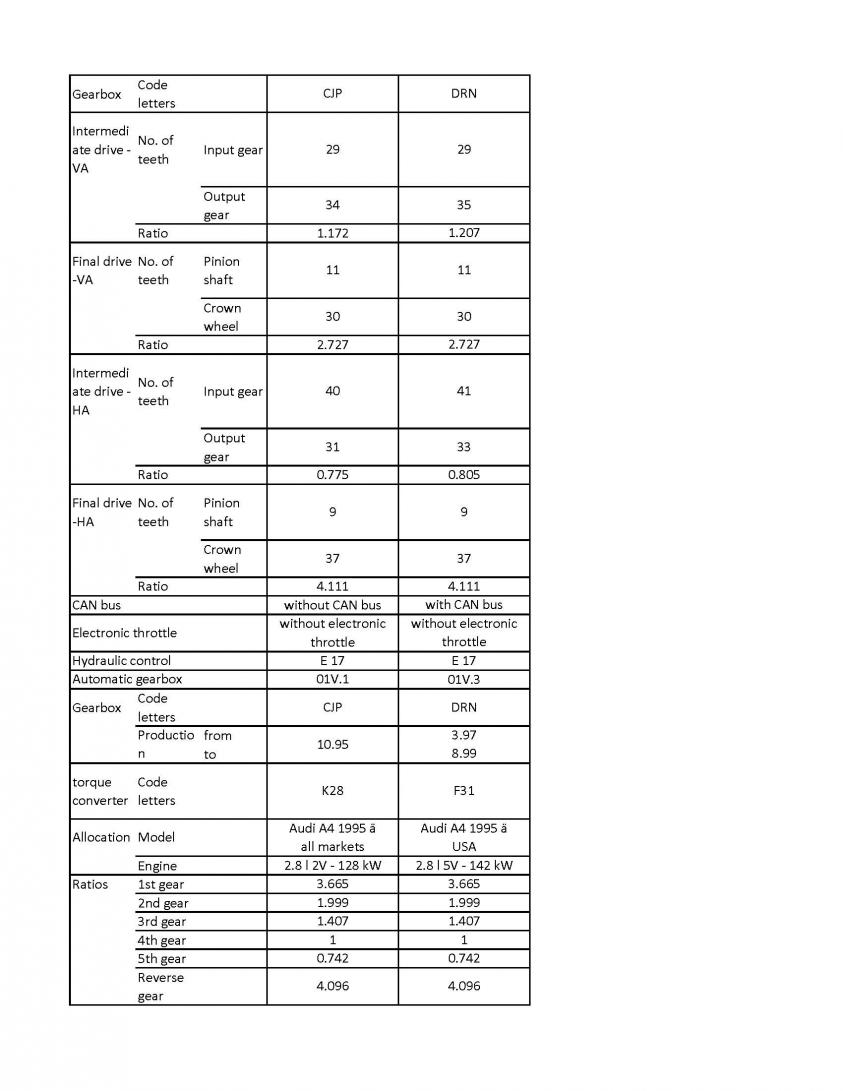

I would think the tranny is still low on fluid. While filling it you have to run it thru all the gears, which means it needs to be up on jack stands, or a frame jack with all 4 wheels hanging, so the wheels can actually turn.
The DRn tranny was used from 3/97 to 8/99 on 30V 2.8L cars. It's a 4.111:1 final drive ratio transmission which is the same ratio as a CJP, some of the intermediate gear ratios inside the two transmissions are different though. This is a table of the features of the 2 transmissions. Not all the columns will line up correctly but you should get the idea of whats the same and whats different. I've attached a jpeg of the info as well.
Gearbox Code letters CJP DRN
Intermediate drive -VA No. of teeth Input gear 29 29
Output gear 34 35
Ratio 1.172 1.207
Final drive -VA No. of teeth Pinion shaft 11 11
Crown wheel 30 30
Ratio 2.727 2.727
Intermediate drive -HA No. of teeth Input gear 40 41
Output gear 31 33
Ratio 0.775 0.805
Final drive -HA No. of teeth Pinion shaft 9 9
Crown wheel 37 37
Ratio 4.111 4.111
CAN bus without CAN bus with CAN bus
Electronic throttle without electronic throttle without electronic throttle
Hydraulic control E 17 E 17
Automatic gearbox 01V.1 01V.3
Production from 10.95 3.97
to 8.99
torque converter Code letters K28 F31
Allocation Model Audi A4 1995 ä Audi A4 1995 ä
all markets USA
Engine 2.8 l 2V - 128 kW 2.8 l 5V - 142 kW
Ratios 1st gear 3.665 3.665
2nd gear 1.999 1.999
3rd gear 1.407 1.407
4th gear 1 1
5th gear 0.742 0.742
Reverse gear 4.096 4.096
Attached Thumbnails 96 A4 2.8 auto: won't start (no spark) after trans change-audi-automatic-transmission-differential-table.jpg
