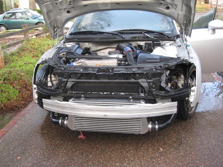

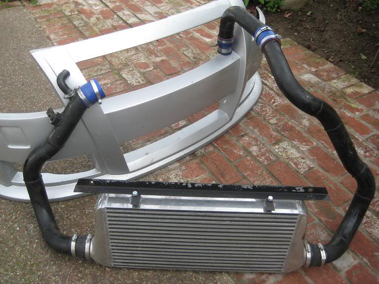

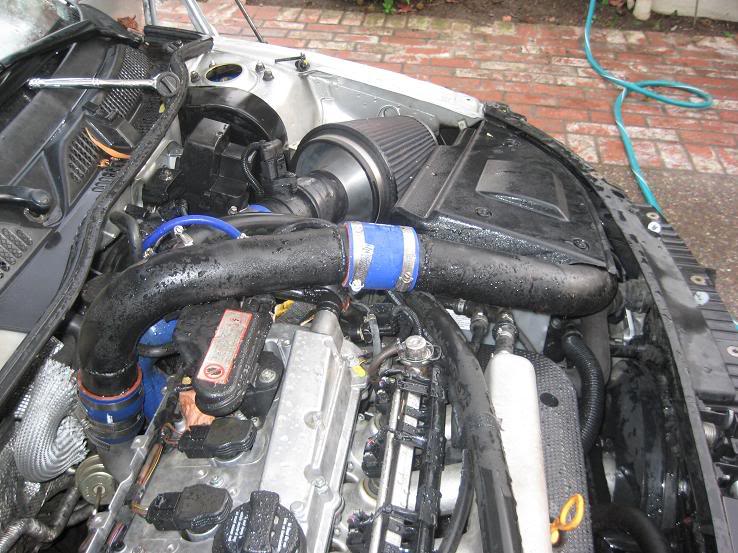

here are some pictures floating around
AND
AND
IC size reference:
