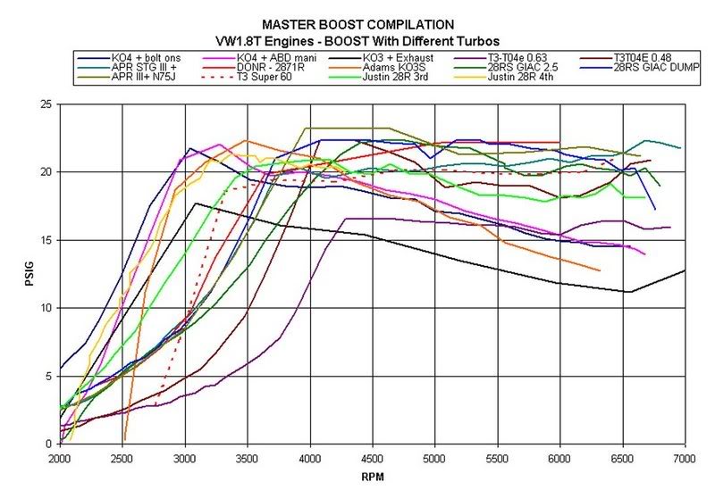

t3S60 or t3/t4 ... yarg.... head hurts so many choices....
the t3t4 hyrbid will hold soemthing around 22 psi i think at redline.. but its freakin hard to find any info on top end boost for these turbos
