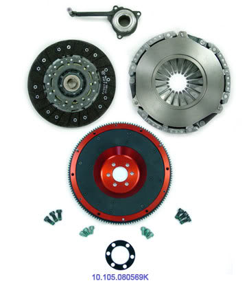

i am replacing my clutch and flywheel and was wondering if anyone is running a lightened flywheel????? im looking at the Autotech to be specific
opinions? reviews?

alot of people go with a 14 lbs flywheel, the 9lbs tends to be too noisy

I'm running the fidanza LWFW, I'm happy with it... the car revs twice as fast.
hows the noise on that? says that its 10lbs

very little chatter, its all in the way the disc is made... if you used my flywheel with a stock disc it would chatter like crazy.

oh and mine is actually less than 10lbshaha we had to mill out some of the center of the flywheel so that the huge springs on my disc would clear.
