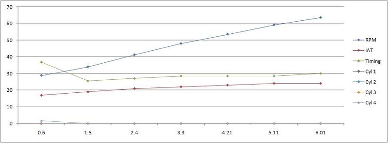

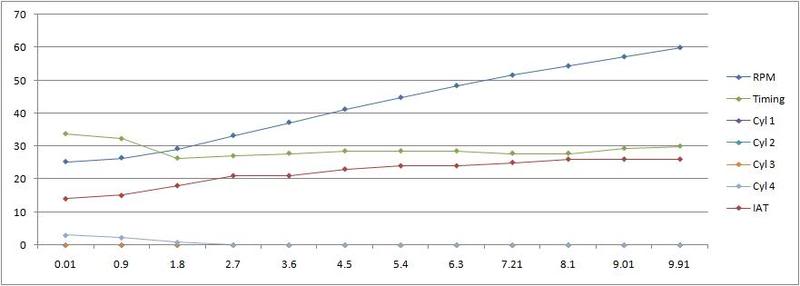

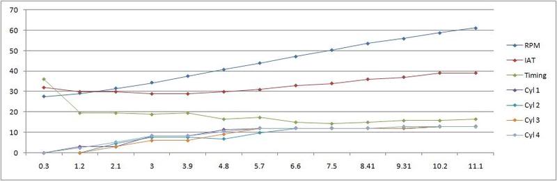

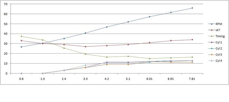

ok here they are... 6 degrees advanced timing; 3rd gear run with and without methanol... and 4th gear pulls with and without methanol.
By the way... this turned out GREAT. without methanol... there was a TON of timing pull and cylinder misfire. with methanol... almost NOTHING.
Heres the graphs. take a look for yourself.
First graph - 3rd gear pull without methanol (notice the huge timing pull on all 4 cylinders)

Second Graph - 3rd Gear pull with methanol (notice almost ZERO timing pull, and the IAT was almost 10 degrees cooler throughout)

3rd Graph - 4th gear pull without Methanol (Again, notice the huge timing pull on all 4 Cylinders)

4th graph - 4th gear pull with methanol (again, almost ZERO timing pull, nd more than 15 degrees cooler than the "without methanol" pull)

That is ALOT of timing! Everything looks good, also keep in mind that those are *C and not *F 15*C is 59*F, thats a nice decrease in temps. So Chris, you notice anymore gains with the extra 1.5* of timing?

I wonder how much higher I could go with the timing.
Im still getting almost NO PULL when the methanol is on, but its risky since the methanol can run out and yikes...
