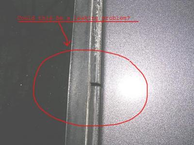

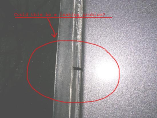

Also, on top of everything else, I also noticed some while back a gap in the sunroof's weatherstrip. I'll have to plug that somehow, too...

Well, the gap in the weatherstripping was the least of my trouble. Actually I discount it as being a non-factor whatsoever, but I will fill it up with a piece of rubber. As it turned out, that crossmember I was talking about was the damn reason for the sunshade getting soaked!
