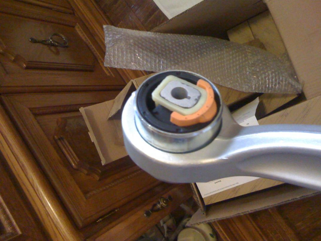

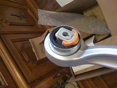

So I'm about to do the control arms again after about 2 years on the last ones. I ordered the FCP groton group buy ones. I was wondering about this orange rubber and plastic around the center thingy that is in the bushings for the lower arms, do I pull this out or leave it? Last time I did the lowers I left this extra rubber and plastic in and it eventually broke apart...
