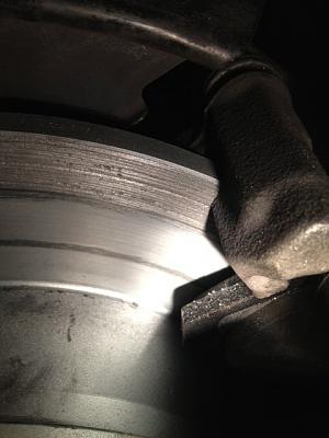

I got my new correct rotors and pads and put them in. It is still making a rubbing sound and I looked closer and saw that the top notch of the caliper bracket is rubbing against the rotor. It does not seem obviously bent, but it must be. Remember that this all got messed up because I was given the rotor with the 1.75" rotor hat rather than the 1.5" rotor hat. How do I fix this? Just get a new bracket or is the hub and caliper also messed up?

I see there is a guy parting out an '01 on this forum, you might see if it has the same parts...sounds like you might have bent something unless you can bend it back and make sure you are not creating cracks you might do well to replace the caliper mounts. Maybe if you could take some good pictures someone on here might be able to tell you what is wrong?
