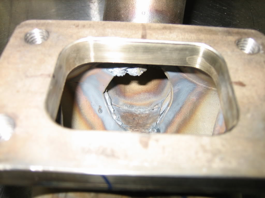

one thing i would suggest as far as what you need out of a exhaust manifold, is a what you are planning on doing with your motor and what turbo you're going with.. if you are buildingyour motor/head and plan on reving up to 8000rpms or more, then i would suggest going with a equal length tubilar manifold. but NOT the 034 unit. from what i have seen, their welder looks like he/she's bllind in both eyes and has both hands tied behind his back when he's fabbing up the manifold. one guy has had to sent back his 034 manifold 2 times now due to this. and horrible fitment issues that give ATP a run for their money(FYI, 034 will build you a downpipe. but Full-Race no longer offers downpipes for their manifolds, you much fab that one on your own) but here's some problems with the 034 mani,
non pentitrating welds

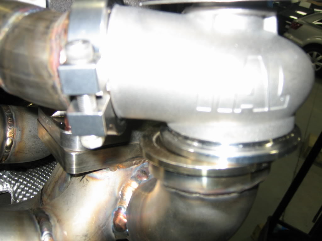

horrible fitment issues. like this, manifold, turbo, downpipe is all bolted/clamped together and this is how far the WG flange is off..
all this cost a customer more than 2 months time and had to do some clean up work himself on his own time. this is not something i would risk when paying $900 for a manifold.. if i were to go tubi mani, i would go with Full-Race. no doubt about that. it's a little bit more money, but you are not going to see these problems with them..
