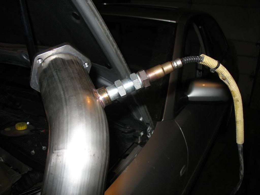

Ok, so I am installing NO ANTI -FOULERS IN THE FRONT.
Front o2 to Test-Pipe (no foulers)
Rear o2 to (2) (anti-foulers)
Or am i matching both rear and front with (2) foulers each?
Confusing that crap outta me!
ORIGINAL: ThePaintballGuy
Yeah the rear O2 sensor is what monitors whats going out of your exhaust. The front one will read the exact same as before when you had your Cat installed. You want to non-foulers on the rear O2 sensor so it thinks it's reading the same as before.
josh
  #19
Old 10-28-2007, 11:14 PM
Audi_Skydiver's Avatar
Join Date: Aug 2006
Location: Phoenix Arizona
Posts: 5,769
Default RE: Test-Pipe/Borla/VDO Oil Gauge Multiple issuues
Nope, put 2 of them in the rear O2 sensor spot. Non in the front.
Josh

Got it!
Josh
