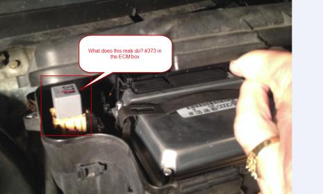

BTW, what is the relay marked 373 in the ECM box for? it does not seem to click in, I pulled it and tested it and it is good.
