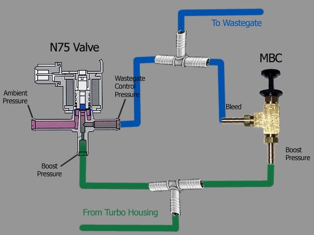

Ok, I am having a little bit of not really a problem but a minor inconvenience. If I am on the gas but only about 1/2 throttle to 3/4 throttle my boost jumps all over the place. It jumps from about 10psi-20psi or so. If I am WOT then it's fine but otherwise it does this. Any ideas? I am thinking maybe something with the MBC. I am running just that and bypassing the N75 completely. If I hooked that back up would it smooth it out? Thanks.

hook up your N75 inline with your MBC - that should help

^ thats way to much crap for me. But yes, the problem is due to the ball and spring mbc. You should look into just running the mbc after the n75 or gettting a mbc with both a bleed valve and a ball and spring on it. Look at the turboXS mbc or the nice knock off by voodoo boost controlers. The ball and spring will still give you a fast spool up and the bleed will smooth out the boost onset and get rid of big spikes

I have a bleed MBC. Same one as Onepoint8tee.
