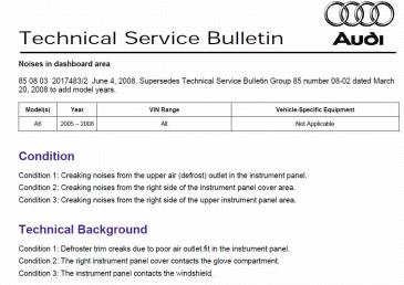

Stevo, do you know what the reference number for the TSB is please? I'm going to take mine in to the dealer as I have this problem also. Rattle but if I press the RHS of the glovebox door when it's shut the rattle goes away. If there's a TSB then it's a known issue and should be covered by my warranty.

Default Technical service bulletin
Sorry its been a while but I couldnt find document. I have attached a screenshot, but if you want the full doc give me your e-mail address as this site restricts file sizes.
