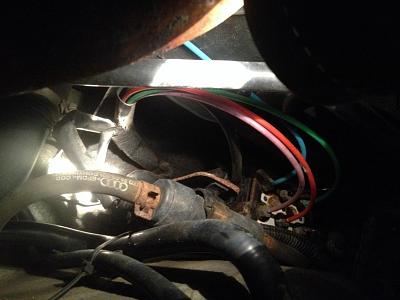

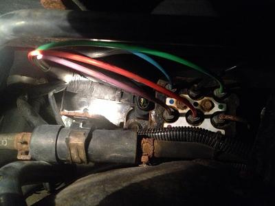

Well I will chime in here for some advise.
2004 2.7T Both front lowered below level 1 and rear sitting up at like level 2.
this just happened a few days ago. I did my oil change. Now what I didn't do is place the suspension in service mode as I didn't know to do this.(1st Audi allroad owner)
The compressor goes on for about a minute, the lift light blinks on level one for that time and then the compressor stops no lift in the front. Compressor a bit louder then when I got the car a month ago. And all levels were working. Dashboard light goes on.
I am ordering the rebuild kit for the compressor. Hope that works like a charm.
Also getting a VAG COM. Hope all this helps.Now I did crawl under the car to look at the compressor location and things don't look as good as I would have kept up with it but then again it's the weather and elements.
Rusted bolts and screws, clamps too, see images.
All the help is welcomed
Thanks
Thanks
